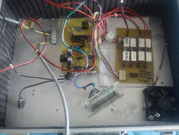

The AVR controller supports either 6 RC servos or 2 full H-bridge PWM channels to drive the motors. The connections will be made in the same ports and its function will be selectable by dip switches.
- 10bit (1024) motor speed resolution
-2 actuators/motors support (in latest firmware 1.0)
-2 full PWM channels, 2 - 8bit pwm channels (Not implemented yet the extra channels lack of timers).
-4 servo signal outputs (not implemented in latest firmware)
-4 potentiometer inputs (that sets the max travel angle and the proportional speed.)
-LCD support
Det er til at styre 2 viskermotorer som servomototorer. Det kan bruges til alt muligt. Bl.a. racersimulator eller elektrisk gearskifte på en bil.. Kun fantasien sætter grænsen....
Skulle lige vise det til en..
